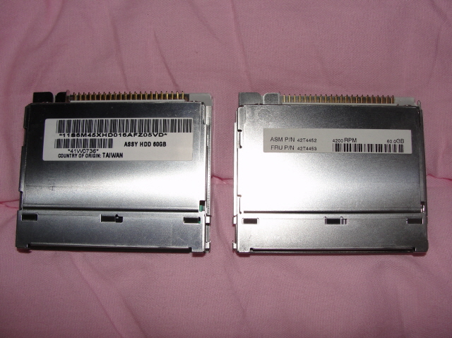

IBM官方网站对联想官方X4 SSD的介绍:
地址是:http://www-307.ibm.com/pc/suppor ... ?lndocid=MIGR-69154
Replacement HDD FRUs for X40, X41 and X41 Tablets - Usage and Limits
FRU HDD looks different and HDD door does not fit on replacement HDD. FRU HDD does not work or fit in external device (USB) or 2nd HDD adapter.
Affected Configurations
Any of the following ThinkPad systems running the Windows XP operating system:
ThinkPad X40 (type 2369, 2370, 2371, 2372, 2382, 2386)
ThinkPad X41 (type 1864, 1865, 2525, 2526, 2527, 2528)
ThinkPad X41 Tablet (type 1866, 1867, 1869)
Solution
New FRU must be plugged into primary slot only. Users who require software HDD cloning will need to ensure that they clone to the new HDD inserted in primary slot.
Two alternate FRU are being provided as replacements for the HDD originally shipped. The new devices are functionally equalivent in speed and capacity, but the new FRU drives are limited to operate in primary HDD slot only. There is a mechanical tab that prevents users from plugging the new FRU drive into the 2nd HDD adapter. The new FRU drives require 3.3 volts to operate and external adapters typically supply 5.0 volts. The drive will not operate at 5.0 volts.
HDD Original FRU Alternative FRU
40GB HDD 39T2545 42T4451
60GB HDD 39T2547 42T4453
If a second hard drive is required for use in the 2nd hard drive adapter while installed in the X4 dock, then the following OBI hard drives will fit and function in the 2nd drive adapter.
HDD Part Number
40GB HDD 08K9816
60GB HDD 73P3357
The photos below illustrates the mechanical differences of the new FRU drives.

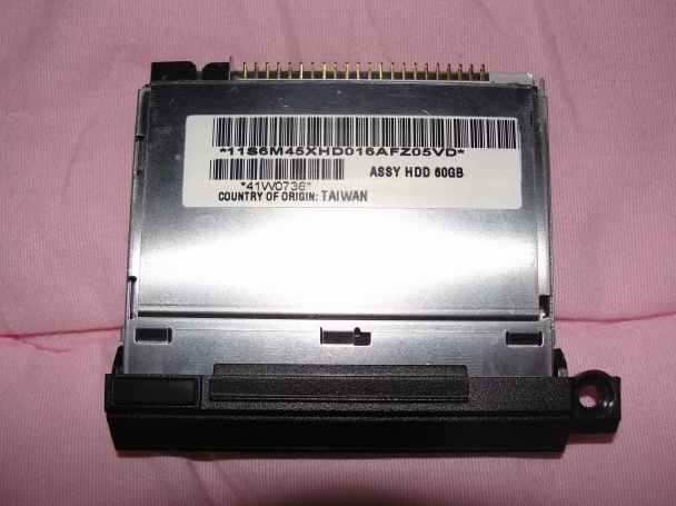

不過接著就有人拿出來Lenovo SSD FRU#41W0736來倒貨....
雖然覺得很誇張 不過我看到第一個試用的美國人的評價還算正面
就敗了一台下去,雖然毛毛的...第一次敗這麼貴的玩具..玩掛就鳥了...
(他買的時候才USD$18x, 我買的價錢是USD$220, 剛剛上ebay去瞄一下居然有人開賣USD$27x)...
拿到的外殼上面寫 Origin from Taiwan, 感覺比較放心一點.
(外殼包裝還貼有Lenovo的封條) <--雖然又安心一點 但你知道這年頭騙人的人很多..)
可是外表真的是蠻不討喜的,很沒質感,聽我問第一個賣refurbished的賣家說裡面的chip是samsung的
不過我沒有勇氣亂開我的貴貴玩具看看是不是真的.
裝進去時候,居然不用換caddy,直接把X41 tablet的硬碟蓋拆過來裝上就可以放進去了.
(這是第一次覺得 這可能真的是lenovo驗證過的FRU)
然後最重要的是開進去的時候沒有出現Error 2010 !!!!
(天啊...這不會是真的是官方驗證過的FRU吧...)

好消息,確定Lenovo 真的有推出SSD for X40 X41 的replacement
我的那台SSD長得就像官網的這張照片一樣...
只是為什麼FRU#不一樣呢....
這個SSD的好處是完全fit Thinkpad..(因為是Thinkpad的parts嘛...)
然後我也確定我的這台SSD是Samsung的MCCOE64GEMPP, 只是不知道控制chip是那家的.

superhcs wrote:
42T4453,是z...(恕刪)
嗯嗯...superhcs大大說的是, 我買的這台SSD FRU#41W0736可能是zif轉接套件加Samsung 60G SSD
因為從外殼的縫看進去可以看到裡面的機板擺得斜斜的...好像不是很合的感覺..

X41T只能用X4 Dock FRU 26R8536
X40 X41 則可使用X4 ultrabase以及X4 Dock。
